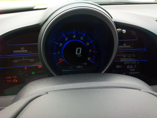

  14. jpleong
    jpleong Well-Known Member
    And some pictures:
    This is the (awesome) dash of the CR-Z. As you can see, everything is laid-out logically and follows a similar ethic to the Insight II dash. We also have the return of mostly digital readouts. The very nice thing is the SoC (state of charge) indicator that isn't nested in the MID menus.
    As you can see in the bottom right, it is capable as a high-FE machine -that's a combination of my awkward steady-state driving (north) and Wayne's actual advanced hypermiling (south). Now that I think about it, that number includes Wayne's stability test, too. Can't wait to see what the CR-Z is capable of when Wayne actually hypermiles her...
    JP

  16. WriConsult
    WriConsult Super Moderator
    Being able to see SoC and AvgFE simultaneously is a nice change from the other hybrids I've seen.
