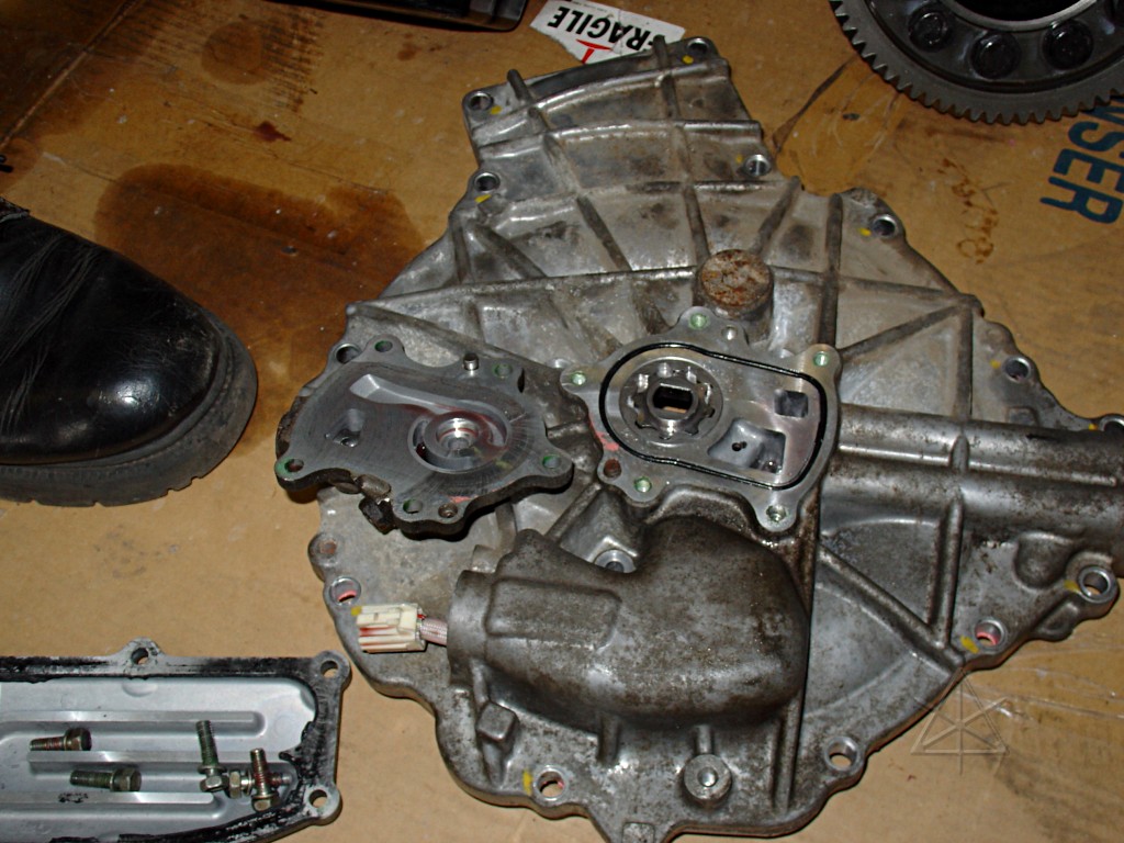

___Also, does anyone have any info on the ICE pump involved in HSD? I do not even know what it is let alone where it is or what it does? Any idea as to the period of time you can run in EV or speed(s) before that pump must run for a few seconds or minutes? When Jud mentioned it to me last Saturday, I must have looked like a deer in the headlights

The transaxle lube pump question has been floating around for years. Now that there are 50-ish Prius PHEVs on the road, I hope that somebody checks the fluid for wear metals. It's the only way we'll ever know for sure.

See this pic and this diagram. The pump is at the opposite
end of the transaxle from the engine, and sends a gentle flow
of transmission fluid down the assembly of shafts where small
holes let some out into the bearings along the way as well as
the final-drive chain. It doesn't seem to go much of anywhere
else, just ensures that those parts stay lubricated. The pump
is paradoxically turned by the *ICE* shaft which passes [in
two pieces] all the way through the middle.
It is already pretty clear that the bearings [the majority of
which are ball or needle, so they're already very low-friction]
stay adequately lubricated over long periods of engine-off time.
The transmission fluid isn't involved in actual power transmission
like it is in a normal A/T; it's just a lubricant which is one
reason its service interval is so long. The jury is still out
on *very* longterm lubrication issues, such as when weeks on
end go by and someone's commuting to work under EV only and
avoiding even the brief warmup run by invoking EV mode early
enough and staying under 34 mph. Just one shot of ICE-run now
and again is enough to circulate some fresh fluid down the
shaft assembly.
